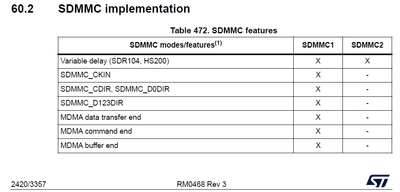

This table in RM0468 says no (X = supported):
2026-02-03 12:53 AM - edited 2026-02-03 5:50 AM
I think you are confusing MDMA and IDMA.
The RM / table 472, states the synchronization availability between SDMMCx and MDMA (an external DMA). For SDMMC2, this synchro is not available. While IDMA is an internal DMA of the SDMMC which is available in both instances: SDMMC1 and SDMMC2.
2026-02-03 3:00 AM
@mƎALLEm yeah, I read too quickly over that... :D
Thanks for the clarification!
I can definitely work without the MDMA flags, without the IDMA would have been bad.
