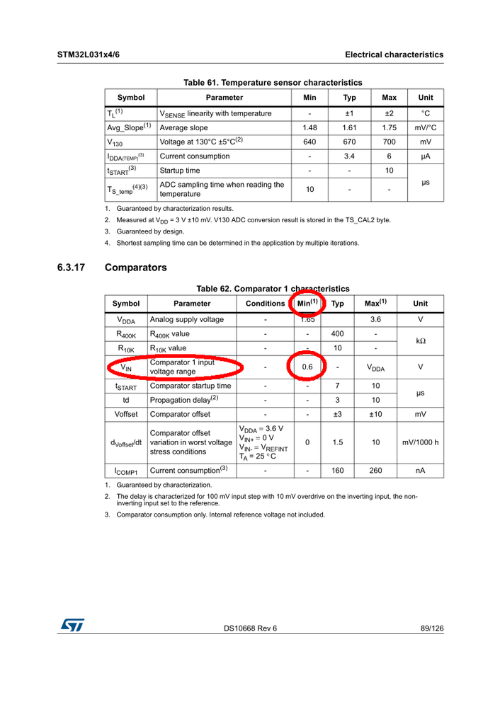

I have no experience with the comparators in 'L0, but maybe this is the reason for the behaviour you observe:

maybe the issue come from COMP1 electrical characteristics, but the purposes were
so I expected correct behaviour of comparators.
2018-12-03 4:59 AM
What I want to say is that COMP1 may inject the current you see if you try to pull it below 0.6V; and as you have both comparators' pins connected, that prevents the other comparator to see the lower transition.
Maybe try using two individual dividers.

Jan,
maybe you are right, but on board it's very difficult to isolate some pins and keep signals.
And in datasheets there are poor COMPx's electical characteristics, in particular for leakage current and/or particular operating condition you named.
