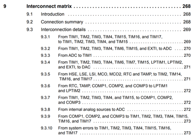

They would be listed in the interconnect section of the Reference Manual. There are some pathways from COMP -> TIM, but none that would enable encoder functionality that I can see. You'd need COMP1->CH1 and COMP2->CH2.

Ok, thanks for the reply. Did you find this documented anywhere or do you just know from experience?
2025-07-01 10:34 AM
