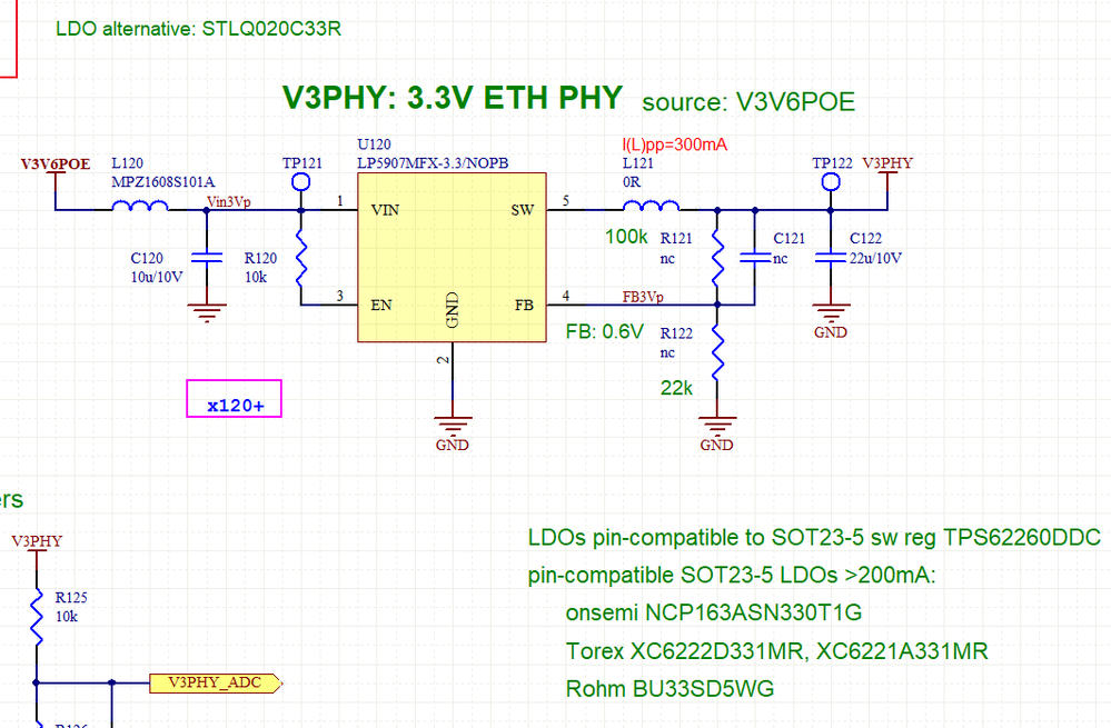

Interestingly, there are almost pin-compatible LDO / buck regulators in SOT23-5/6 out there, so for some designs I basically put the buck circuit on the board, but if an LDO was good enough, I just bridged the inductor:
