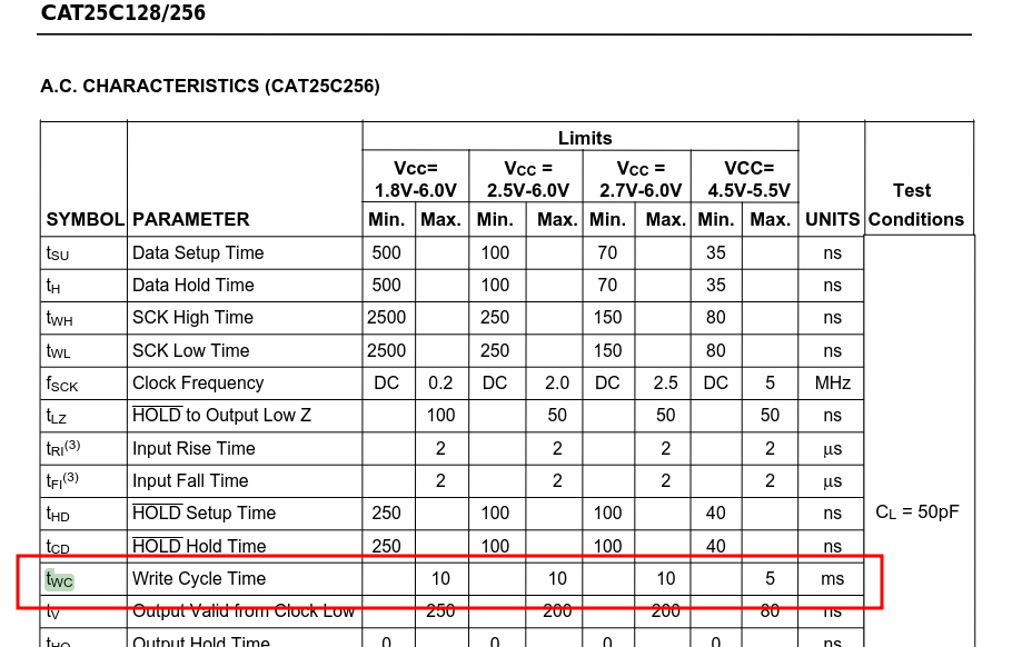

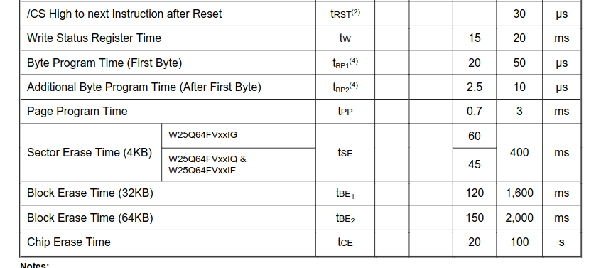

EEPROM generally takes a long time to write, if the idea is to release the main code, it may be interesting to use a timer to periodically carry out the tasks of checking whether the writing operation is over and filling the data transmission buffer, or waiting for the time maximum and then send the data. A verification reading can be interesting to know if the data was saved correctly. For example W25Q64 (FLASH):
- Page Program Time
A 25Cxx EEPROM has the maximum TWC parameter (5ms, 10ms), which is the time each byte can take to be written into memory. Which can be even worse than FLASH, but on the other hand you don't need to erase the whole sector like W26Q64.
