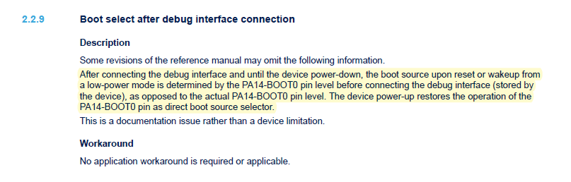

Actually, I just figured out why this behaviour was occurring. This is from the STM32G030F6 device errata sheet:

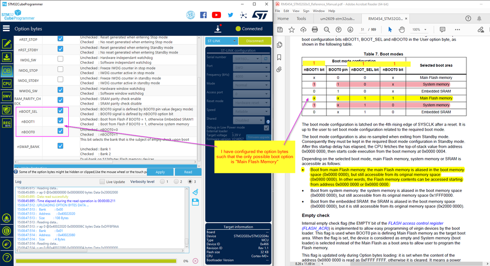

The problem is that I have the option bytes configured to not care about the BOOT0 input (see screenshot below). From my research it seems like this should be impossible?
