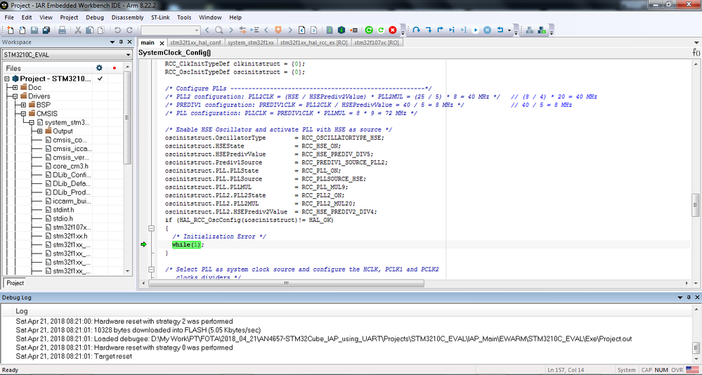

2018-04-21 1:37 AM
Thanks Sir
Turvey.Clive.002
. Now I am using STM32F103RE that has 64k ram. But when I configure its clock, debugger gets struct in while loop atif (HAL_RCC_OscConfig(&oscinitstruct)!= HAL_OK)
{ /* Initialization Error */ while(1); }Please check the following modification for 8 MHz HSE. Am I doing it wrong?
I am using following IAP example
.\AN4657-STM32Cube_IAP_using_UART\Projects\STM3210C_EVAL\IAP_Main\EWARM\STM3210C_EVAL\

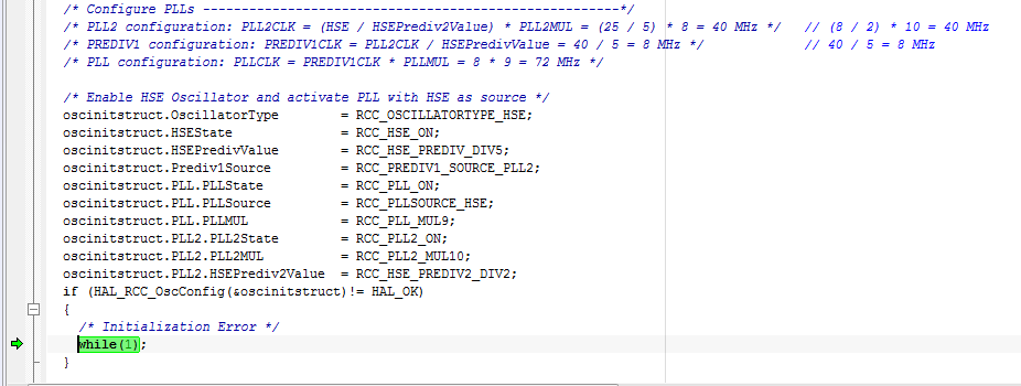

2018-04-21 3:46 AM
Even it is getting struct with following configuration as well
