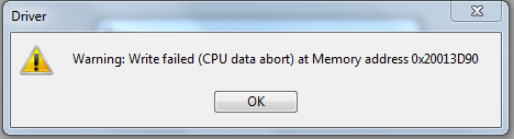

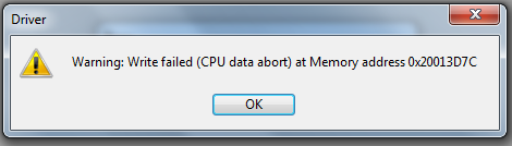

However, I get error (attached as images) while doing same test with STM32F103C8 using support given in
.\STM32Cube_FW_F1_V1.6.0\Projects\STM3210E_EVAL\Applications\IAP
Sir I have STM32F103 on board therefore I need it.
