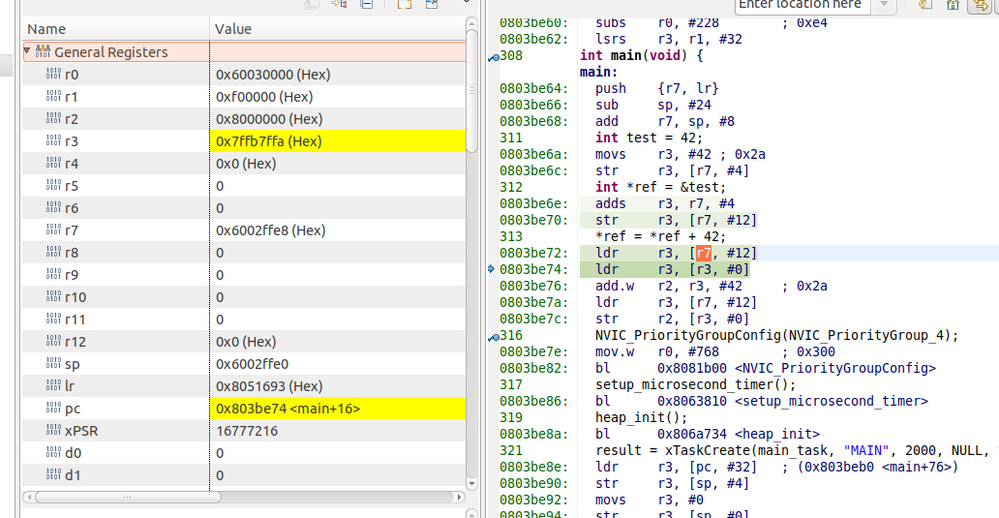

*ref = *ref + 42;So far so good. After compiling and flashing the stm32 runs very well into the main routine. I used the debugger to verify that stack pointer is set right in the startup assember code. The test statements I added in the main does not work. Take a look to the debugger view:
It looks like the value stored by`str r3, [r7, #12]` in the RAM canote be loaded by `ldr r3, [r7, #12]`.
So the processor "thinks" the register R3 had been stored to RAM. But the Value of R3 has never been written to extern RAM or cannot be read back.
Does anybody know how to go on from here?

I had a look to schematics and your're nearly right. The SDRAM is not located to 0x60000000. It is located to 0xC0000000 which is the SDRAM bank 1.
Using the Debugger to write manually to the SDRAM showed that writing to 0x60000000 or 0xD0000000 is not possible. Writing to 0xC000000 works partially. After writing 0x12345678 the value which I read back is 0x56785678.
I thought the Examples of ST would run out of the box. But it really looks like I need to read and understand the whole FMC documentation and the SRAM Wiring...
