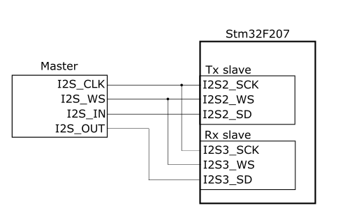

Yes. Set one of the I2Sx/I2SxExt couple as Slave Receiver and the other as Slave Transmitter.

I'll have to connect I2Sx_WS and I2Sx_SCK on the same master signal?

What do you mean by "same master signal"?
Post a diagram/sketch.

Here a draft sketch.
The I2S master clock and word select going to both I2S slave interface.
2020-06-30 10:02 AM
Yes, that's it.
Sorry, I was under the impression that 'F2 has all the peripherals 'F4 has - and 'F4 have additional I2SxExt modules which have the SCK/WS connected internally.
2020-07-01 6:49 AM
This is what I feared.
I do not find any migrating guide from F207 to F407, does it requires a lot of work?
2020-07-01 7:13 AM
The 'F407 is almost entirely identical with the 'F207 - this is why I didn't even check first.
The two notable differences are the Cortex-M4 processor, which is fully backward compatible with the CM3, and the higher maximum clock.
It may be worth having a look at the lower-end F4 line. They are not that much compatible, but still may fit the bill.
