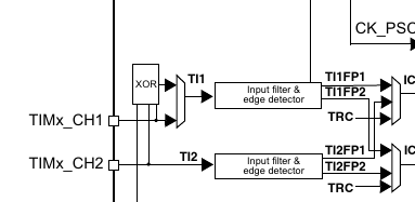

Or use a TIM pin where the CH1 / CH2 trigger on upposing edges of the TIMx_CH1 input pin (CH2 can use via Indirect Mode, ie criss-cross of CH1<->CH2, and CH3<->CH4)

A TIM should be able to cross connect one pin to two channels via indirect mode.

What is a TIM and how much added latency are we talking about?
2022-09-04 10:59 PM
TIM -> timer
