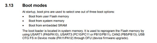

The below document explains bootloader options only in USART1 , CAN2, USART2 and not i2c for stm32f2xxx series

Right but that's ISP not IAP
In-Application-Programming infers you're going to have to own that, using whatever pins, peripherals and protocol you choose, and the host side delivery of the update.
2023-04-13 11:17 PM
The ROM based system loader isn't going to manifest board and peripheral specific functionality that will support your use case.
Create your own loader in the first flash sectors of the part, which are the smaller 16KB and 64KB ones. Put your application in the deeper in 128K sectors, and let the loader manage and validate it.
