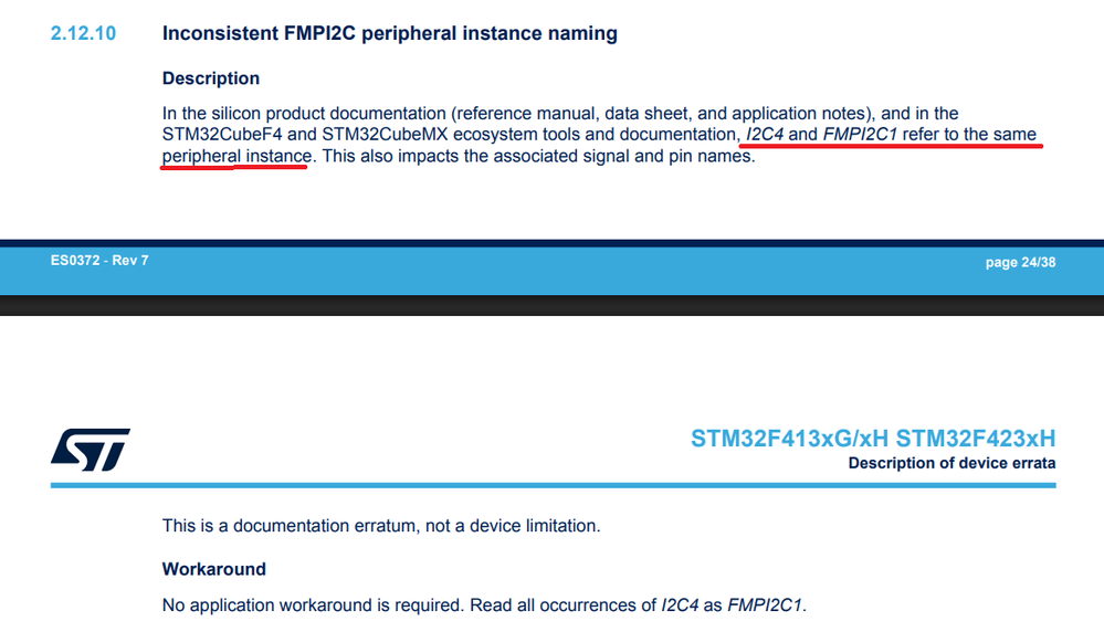

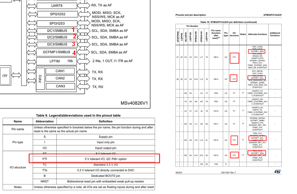

Getting back to this question.
RM0430 and DS11581 are referring to FMPI2C peripheral which is not the same instance than I2C1.
In RM0430:
Section 26 Fast-mode Plus Inter-integrated circuit interface (FMPI2C) (100kHz, 400kHz and 1MHz) refers to: FMPI2C while Section 27 Inter-integrated circuit (I2C) interface (100kHz and 400kHz) refers to: I2C1, I2C2 and I2C3.
In the datasheet DS11581, all pins with FMPI2C or I2C peripheral are named:
I2CFMP1_SDA or _SCL
I2Cx_SDA or _SCL
This naming convention is the same for STM32F413, F412, F410 and F446. CubeMx also uses these names.
In these STM32F4 reference manuals, sections: RCC, there are also some references to “I2C4” which is in fact FMPI2C (and doesn’t exist in CubeMX for these F4 devices).
You can refer to ES0372 - Rev 7 errata doc: 2.12.10 Inconsistent FMPI2C peripheral instance naming:
Hope I've answered the question.

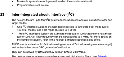

Seems to be a mismatch between datasheet and reference manual here.
The datasheet says it has 4 I2C instances, and yet it has no mention of "I2C4". Not even in the pinout list.
The reference manual says it only has 3 and yet refers to I2C4 in several places.
I tend to believe there are only 3 instances here and that none of them support FM+. This post supports that:

2026-03-06 1:21 AM - edited 2026-03-06 2:41 AM
Hello all,
In RM0430:
I2CFMP1_SDA or _SCL
I2Cx_SDA or _SCL
2026-03-06 2:32 AM - edited 2026-03-06 2:36 AM
Oh, a "terminology" erratum? :shocked:
Well.... the I2C chapter in DS still needs to say all this explicitly, IMO. An "implementation" table (this is quite common in newer families' I2C chapter in DS), with a footnote saying something like "FMPI2C may be called I2C4 at certain places"?
