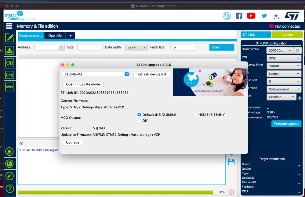

FYI.
You can change the ST-LinkV3 MCO config to generate the clock from F723 HSE.
But, resulted clock freq becomes 8.33MHz (sigh...)
2021-05-05 7:32 PM
thanks, that will come in handy!
