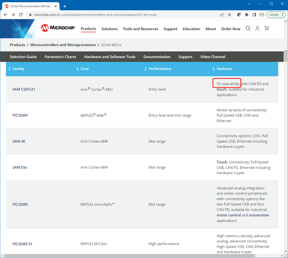

Actually, they don't - very few manufacturers have 5V Cortex-M microcontrollers.
IIRC, Microchip (formerly Atmel) has only one?

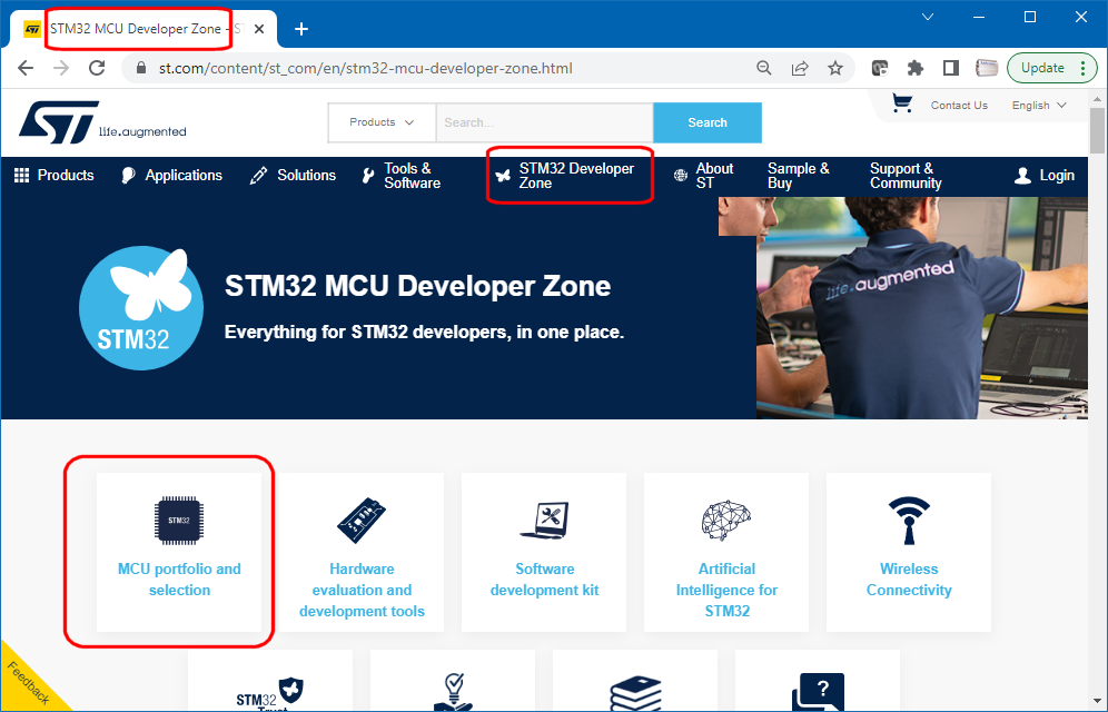

Have you tried the "STM32 Finder new mobile app" ?
https://www.st.com/en/microcontrollers-microprocessors/stm32-32-bit-arm-cortex-mcus.html#st-highlight-promotion

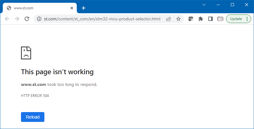

Or the Product Selector?
Although that seems to be broken at the moment:
