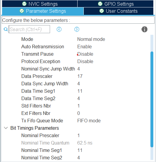

I'm using a NUCLEO G0B1RE board in which I'm trying to implement the FDCAN code with a MAX3051ESA+ CAN transceiver. So is this compatible if I use the Classic CAN mode ? If Yes, what are the parameters that need to be set for the following if I'm using 48 MHz clock for both FDCAN & its kernel clock.
I'm attaching the image as well.

Expect to have to read and understand the datasheets and bus level signaling.
Expect to set those parameters as you would any classic implementation, it's just a transceiver.

MAX3051ESA is a hardware transceiver, it doesnt care which ClassicCAN/FDCan protocol your mcu is pushing trough.
>>So is this compatible if I use the Classic CANbus mode
Edit:
>> & its kernel clock.
If this means youre using the internal HSI, dont.
Use a XTAL external HSE as your system clock.
