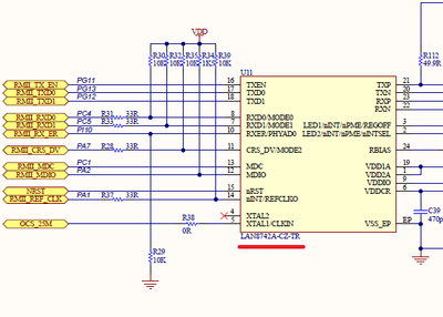

This is what I can provide:
ETH PHY: you can refer to the STM32H573I-DK board schematic:
The ETH PHY used is the LAN8742A.
For LWIP on H5 please read this knowledge base: How to use the LwIP Ethernet middleware on the STM32H5 series
