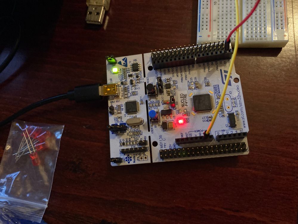

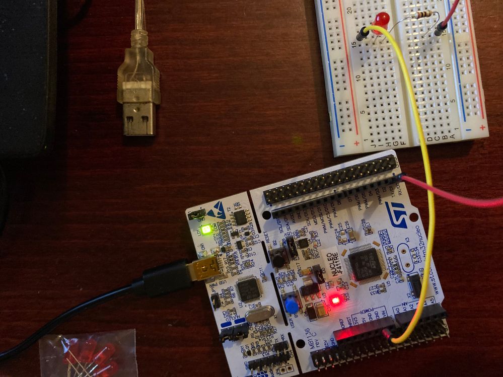

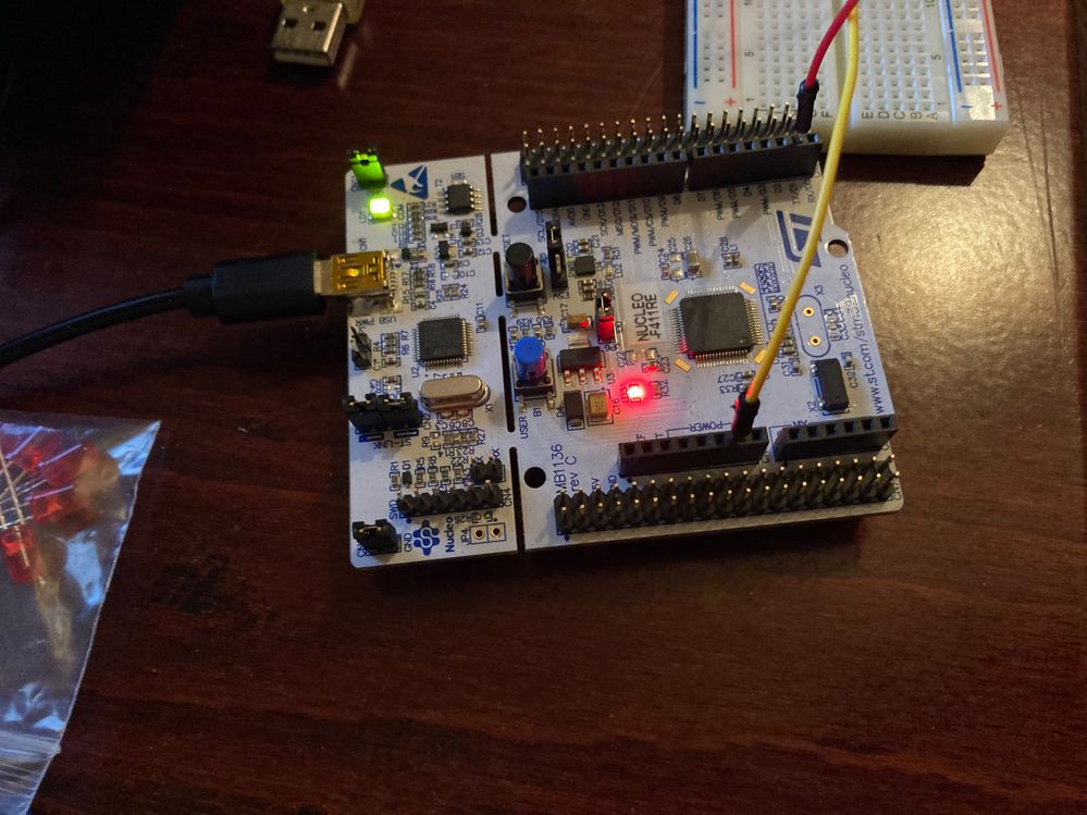

Sorry for this dumb question. Could You show me on the pictures which solder bridge should I remove? I checked the datasheet and I found SB13 and SB14 but I can't see where it joins. I attached 3 pictures about the board.
Thank You! :)

I can't show you with your pictures, because it is on the other side of the board.
In UM1724 page 14 Figure 4 "Bottom layout", they are shown.
