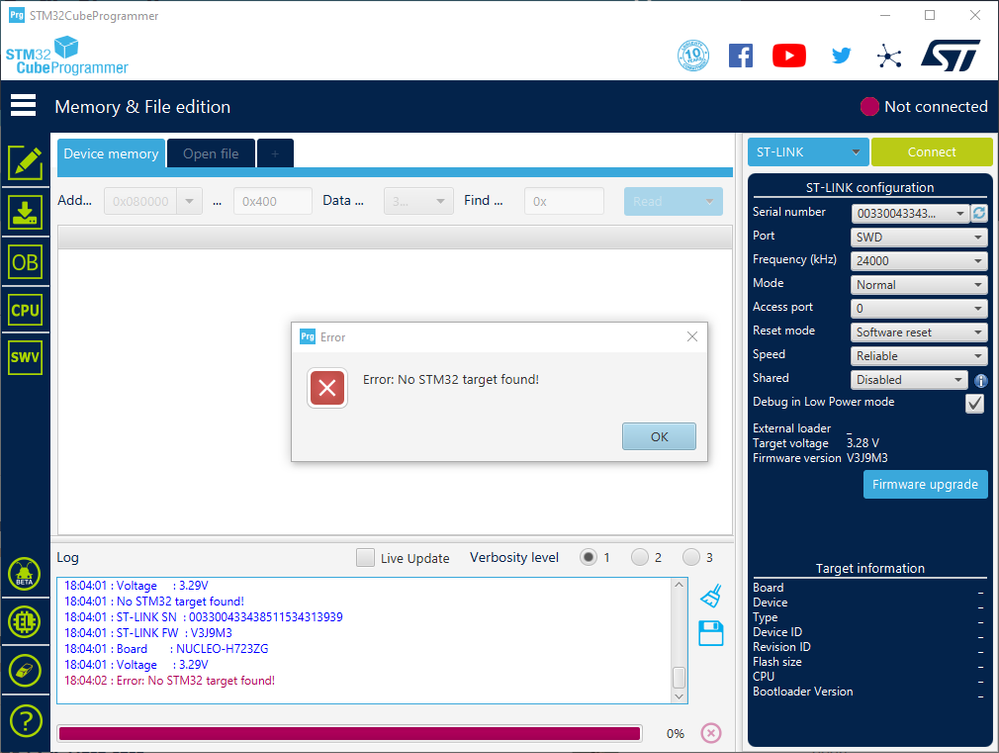

Hi! I am grad student that is a newcomer to the STM32 MCU platform. I want to ask a question about the problems I have been experiencing with my development boards. Is it normal to have to manually press the reset button on the development boards to connect to the development boards?

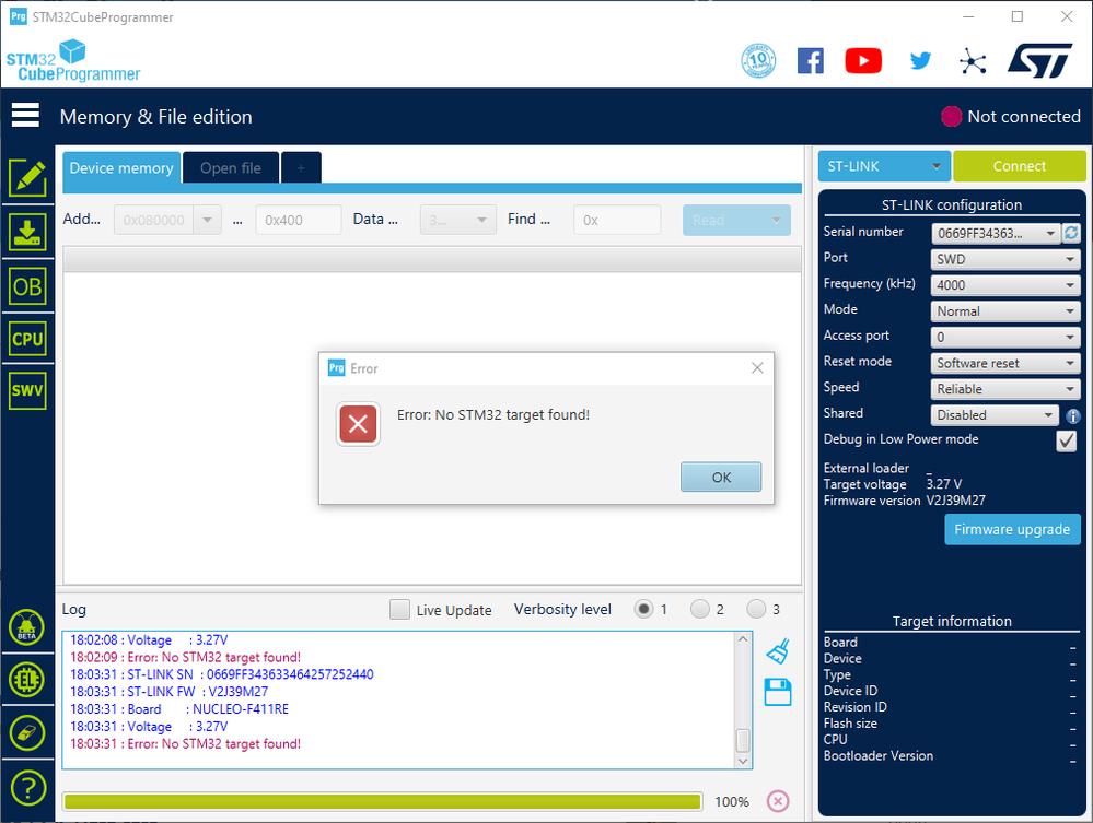

I have two boards, NUCLEO-H723ZG and NUCLEO-F411RE. When I try to connect to a board using STM32CubeProgrammer, it will write an error message "Error: No STM32 target found!" unless I manually press down the RESET button and release it with appropriate timing.

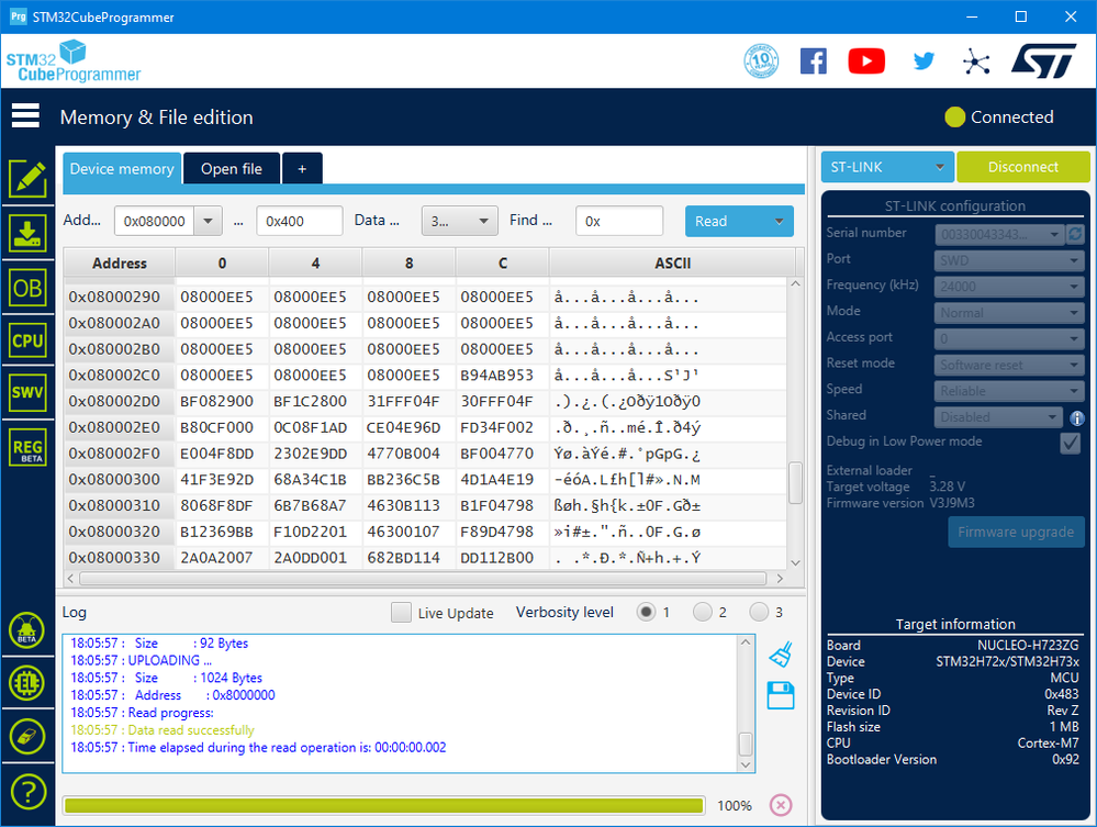

And if I manually press the reset button and release it with the right timing:

No, this is only normal if there is already a program on the STM32 that may be using ultra-low power modes or has been programmed without SWD pin assignment. However, if you set the Reset Mode of the CubeProgrammer from software to hardware reset, you should have immediate access.

Hi @Peter BENSCH and thank you for the warm welcome.
You are right, when I select the hardware reset it successfully connects in STM32CubeProgrammer. This is good to know!
