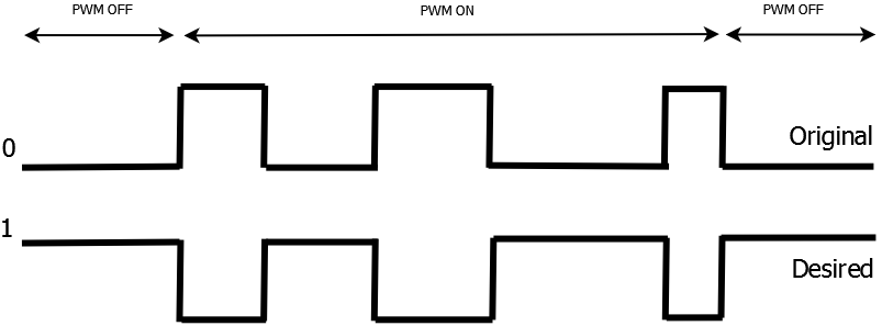

Is there a quick and clever way of inverting a PWM signal in software (I am using timer 2 of the Discovery Kit board/STM32L100)? Was looking for the complementary feature but I don't want a pair of PWMs, just the inverted of the original signal (top).
Thanks in advance!

As I mentioned I was looking for a software solution. Yes I only need 1 PWM (inverted) output. What 'switch' in the Cube are you referring to? This:
sConfigOC.OCPolarity = TIM_OCPOLARITY_LOW;?
I've tried this (changed from
TIM_OCPOLARITY_HIGH)
and it worked but when inactive the signal was low instead of high as seen in the 'Desired' trace.Thanks

Been playing with the OCxM (PWM mode) and the polarity and got the same result: looks good while active (inverted polarity as desired). But I couldn't seem to make the signal HIGH when inactive (PWM OFF time). Is it even possible in single output mode? I know in complementary pair it is possible (make dead band zero).

Yes, the CCxE (or CC1E specifically) = 0 for PWM OFF period (for PWM ON,
CCxE
= 1). Do you suggest going back and forth between GPIO mode (pull-up) and normal PWM mode? This has been discussed internally but sounds kludgy. I was looking for an elegant way of doing it. Otherwise it will be done in hardware.The load on this signal is about 100 mW.
