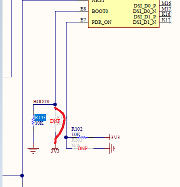

2024-10-23 8:47 AM
I mean in the schematic R144 is not there, if I apply solder to join those ends I would send boot0 to 3.3V and that would fulfill the step of connecting boot0 to VDD and be able to erase the memory and then remove the solder jumper right? with that I avoid soldering a wire to one end of R144 which is very difficult.
2024-10-23 8:51 AM
You can do that but to unsolder it, it could be a challenge. It's up to you to decide.
2024-10-23 9:10 AM
aa I understand, is that actually that resistor is not present in the circuit only its pads that's why I was saying. actually I don't have to remove any resistor just jumper the smd pads of the resistor that is not present that's why I was saying it's easier than soldering a wire on one of the pins.
Anyway I just did it but it doesn't seem to work I sent boot0 to 3.3V I connected it to stmprogrammer and cleared the memory then disconnected to remove the boot0 jumper to 3.3V and connected to stmprogrammer to load the .hex of the led flashing but it doesn't work, when debugging it stays in loop in the same part of the code.
is there anything I can do? :\

2024-10-23 9:29 AM
I made the following connection for boot0
if that's sending boot0 to vdd then I did everything as is, if you want I can try soldering a wire on one of the points and connect it to some arduino pin like 3.3v or 5v
"which changes the device’s boot address to start the bootloader in system memory instead of booting from the target’s flash memory (which currently houses the firmware that is setting the incorrect SMPS/LDO configuration)."
do i have a way to corroborate that this actually happens when i set boot0 to 3.3v?
2024-10-23 9:34 AM - edited 2024-10-23 9:39 AM
You need to connect and disconnect this wire or "solder bridge" (0V or VDD) following the specific steps described above and you need to follow the exact steps with the same order. That's it.

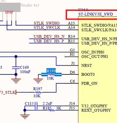

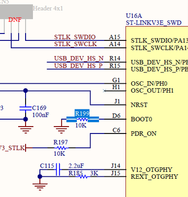

I found this also in the schematic, I will try to put a wire on R199 on the boot0 side and send it to 3.3v.
2024-10-23 9:47 AM
This is for ST-LINK module not for the MCU:
So again follow the steps as described in the article and use R144 to connect BOOT0 pin to VDD.
