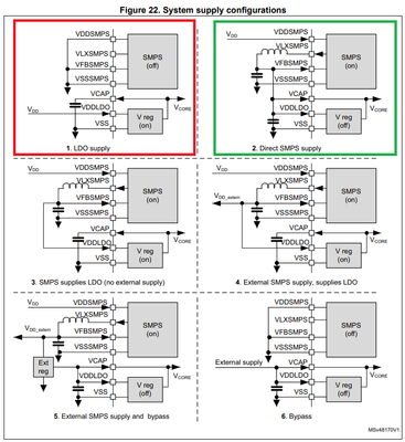

This is why users need to read the documentation before starting a development especially for complex products such as H7 dual core line:
In red is what you configured and in green is what you need to configure for this board. You can notice that the external HW is not the same. So the software needs to follow the hardware configuration:

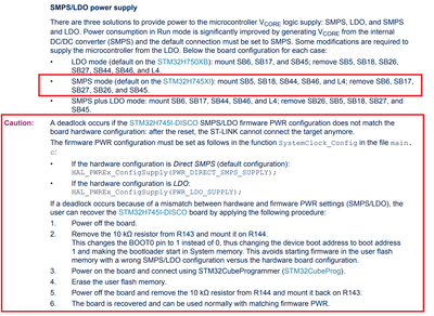

This is what is provided in the user manual of the board:

Second, as you are using a stm32h745i-disco board what, is the power supply you set? SMPS or LDO? What Frequency and what VOS level you set?
On this board you need to set SMPS for power configuration and you can't exceed 400MHz of system clock at VOS1.

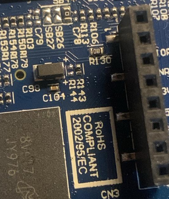

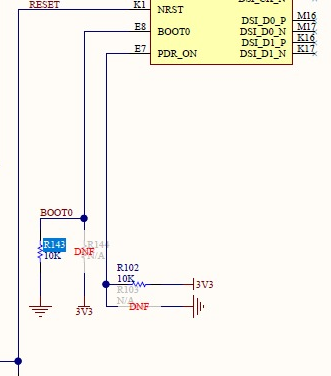

Sorry SofLit on my board it says reference: MB1381B and the schematic I am using says MB1381 is it the same? according to the schematic I have to jumper R144 is it correct? attached photo
https://www.st.com/resource/en/schematic_pack/mb1381-h750xb-b01-schematic.pdf

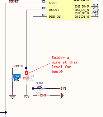

2024-10-23 8:39 AM - edited 2024-10-23 8:39 AM
Try to solder a wire for Boot0 here and connect it to VDD to enter system memory:
