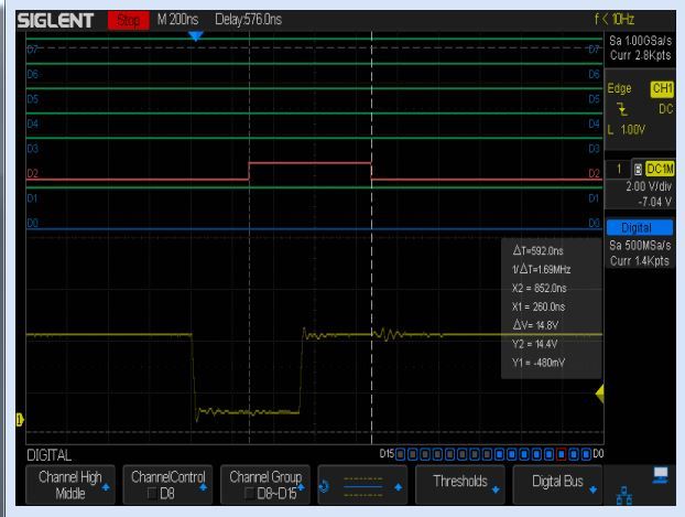

That said... 200ns seems like a long time. If you set-and-then-reset the GPIO in the interrupt, how long does the pulse become? (I'm suspecting you may be using an inefficient function call to toggle the GPIO, causing a chunk of the latency).2016-12-15 8:02 AM
200ns
Seems
like a
long time
but
don't
shy
the
IRQHandler
is
592ns
* @brief This function handles EXTI line0 interrupt. @brief Interrupt SLTSL RD/CS1 4000-8000*/void EXTI0_IRQHandler(void){ GPIOD->BSRR = TestP2; HAL_GPIO_EXTI_IRQHandler(GPIO_PIN_0); GPIOD->BSRR = TestP2<<16; }Yellow = interrupt falling edge pin pc0
D2 = GPIOD TestP2
2016-12-23 4:02 AM
Besides the Flash to RAM to boost, if looking at the interrupt duration, then try this:
EXTI->PR1 |= (1<<0); // clear the pending flag
NVIC_ReleasePendingIRQ(EXTI0_IRQn);// HAL_GPIO_EXTI_IRQHandler(GPIO_PIN_0);
And let us know if it is the same...
Having the ISR executing in RAM and interrupt vectors in RAM would also help.
