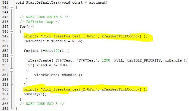

Below added code snippet which is used for testing both F429 and F767 boards. Found the Tick difference between part highlighted.

Do you understand that the first printf() and (I guess) UART transmission underneath is included in your measurement? And xTaskCreate() and malloc() both use dynamic memory and are not deterministic in terms of both - processing time and success of result.

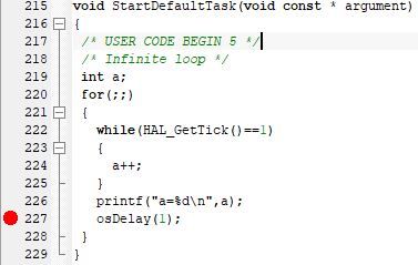

I tried to increment a variable in one tick count and the results are below.
F429 - a=976
F767 - a=691
F767 is not running as many times F429 is running through the code in specific tick.
And the situation is only task running that is this default task and code base is default simple example code taken from STM32cubemx

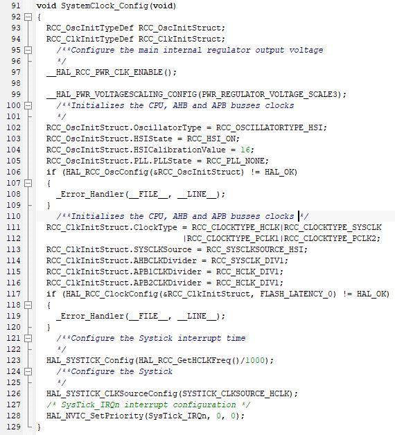

Disable all interrupts (__disable_irq()/__enable_irq()) and use DWT->CYCCNT for precise measurement.
How are clocks, PLL, buses, flash and cache configured?
2020-01-24 3:34 AM
I tried attaching the complete code but it is not allowed here. I am attaching the main function snapshot and system clock config functions snapshot.
Code is taken from STM32CubeMX V 4.24

Results for the below code when kept variable(a) in live watch:
F429 - a=998
F767 - a=661

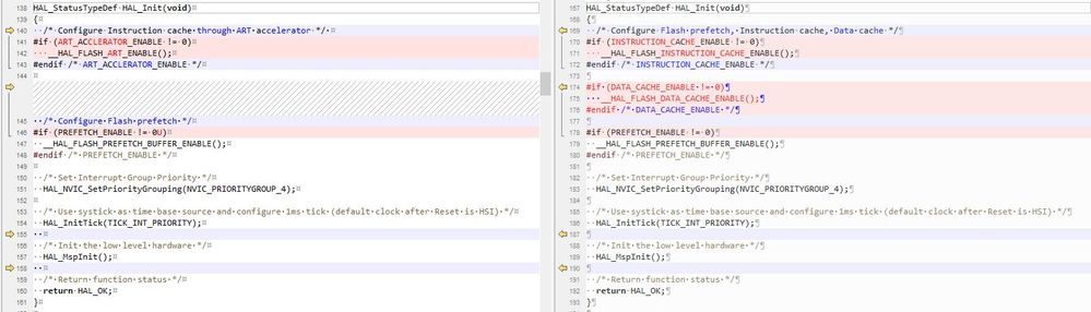

@Piranha @Uwe Bonnes
Major difference in Hal_init() is data and instruction cache and prefetch .
Tried the combinations and didn't find much diffference.
F429-with cache and prefetch enabled - a=998
F429 with cache and prefetch disabled - a=997
F767-with cache and prefetch enabled - a=661
F767 with cache and prefetch disabled - a=661
F767 is slow because of there is no data caching ?

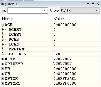

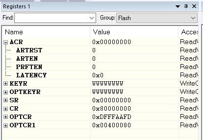

Hal_init comparison F767-F429
F429_Flash_register_status
F767_Flash_register_status
