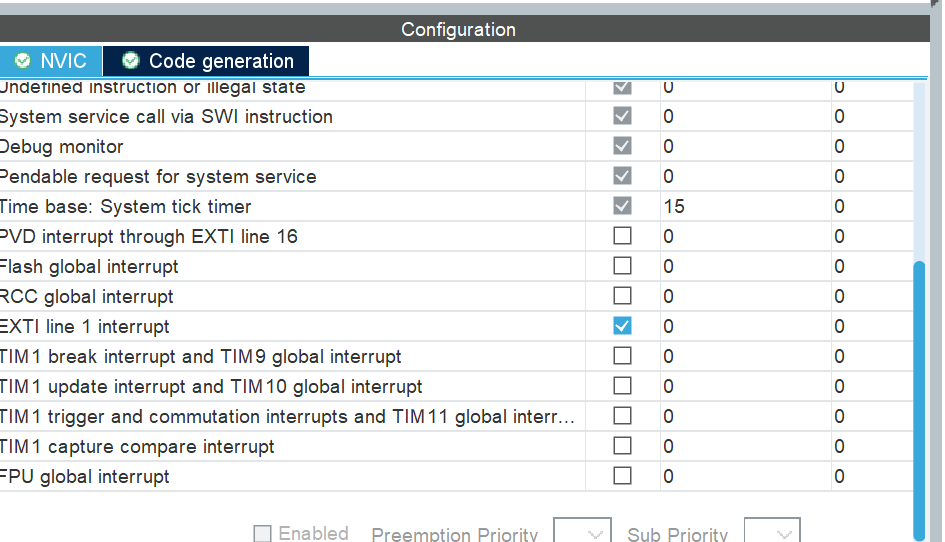

actually I'm using stm32F446RE, I'm using hal library just to detect external interrupt from PA1 pin but it doesn't work, and if I put the interrupt from PA0 pin, it works fine?

Hello @kkhli.1,
Check that the EXTI1_IRQ interrupt is not being masked by other interrupts with higher priorities
2023-05-04 1:30 AM - edited 2023-11-20 6:30 AM
hello ,i'm using only one interrupt
2023-05-04 1:38 AM
Make sure you have connection from physical PA1 pin to the point you think the signal is. Observe input in GPIOA_IDR, or set PA1 as output and toggle.
Read out and check EXTI and relevant GPIO and SYSCFG registers content.
Other than that, follow the usual "interrupt does not fire" checklist.
2023-05-04 1:54 AM
thx for your answers @Sarra.S @Community member , i just replaced the stm card and it works
the pb that the pin PA1 is burnt
