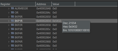

I am using the Internal RTC of STM32F767 MCU.
The VBAT pin is connected to an External 3.3V Coin Cell Battery
At Power ON (Debug window on STM32 Cube IDE), before HAL_INIT when i see the value of RTC BKP1R Register it is 0x5432 as I intended it to be.

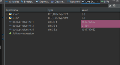

backup_value_rtc_4(uint32_t) = hrtc.Instance->BKP1R;
now surprisingly this reads 1517797662 but it should be 21554 (0x5432)
so when i do MX_RTC_Init
static void MX_RTC_Init(void)
/* USER CODE BEGIN RTC_Init 0 */
if (HAL_RTC_Init(&hrtc) != HAL_OK)
Error_Handler();
backup_value_rtc_1 = HAL_RTCEx_BKUPRead(&hrtc, RTC_BKP_DR1);
// printf("Backup Register Value: 0x%04X\n", backup_value);

HAL_RTCEx_BKUPWrite(&hrtc, RTC_BKP_DR1, 0x5432);
backup_value_rtc_3 = HAL_RTCEx_BKUPRead(&hrtc, RTC_BKP_DR1);
/* USER CODE BEGIN RTC_Init 1 */
/* USER CODE END RTC_Init 2 */
then my RTC gets written everytime.
Now SFR says 5432 is stored, why am I not able to read it correct using the API or directly accessing the register
