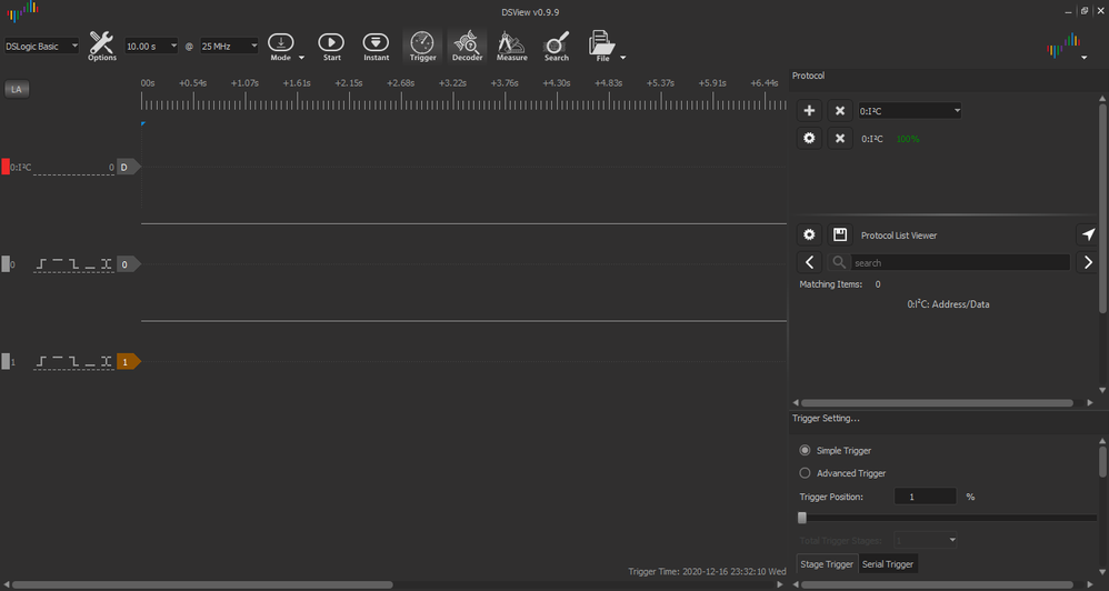

} Note: I have checked the output with a logic analyzer its only displaying logic high.

i have enabled PE before start ,but still no change in output.i guess there is a problem in I2C1_CCR_bit.CCR=0x28; & I2C1_CR2=0x00000008;
but that i dont know how to calculate.any suggestion.thanks
