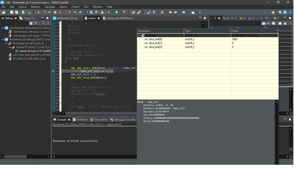

I'm trying to capture single-shot ADC reading from 3 subsequent channels. I'm using CubeIDE and STM32L100RCT6 on the Discovery board, but I have the same results with STM32F103CBT6. I do everything according to that document, but whenever I try, my ADC fills the buffer with only one channel reading, stops, and never starts HAL_ADC_ConvCpltCallback() routine, so it gets stuck in the while loop, which is intended to stops processor and waits for conversion complete:

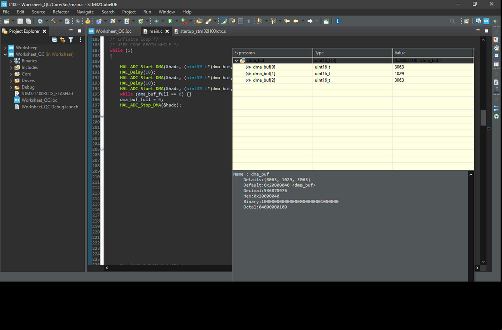

I know it does not look wright, but I've also tried that:
And it looks like it is working, but ADC only reads 2 channels out of 3 and loops (3rd reading should be smaller than 2nd). I attach my whole code below.
Thanks for any help.

Read out and check/post ADC and DMA registers content.
2020-12-18 7:37 AM
Thank you for the advice. I've done so and I've figured it out. As usual, it was a pretty dumb mistake. After checking ADC bits I've noticed that Overrun in ADC_SR was high, so I've raised up DMA clock to keep it closer to the fixed ADC clock and it worked, so it was just a problem with DMA not keeping up with ADC. (Dzięki kolego.)
