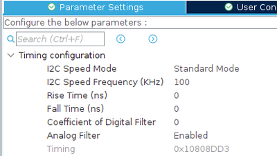

2024-07-08 10:28 AM
And enable the noise filter(s) .
plz tell me how to enable filters for i2c
2024-07-08 11:45 AM
here analog filter on, + dig.filter : if you wanna use, just set it: 0...15 possible.
