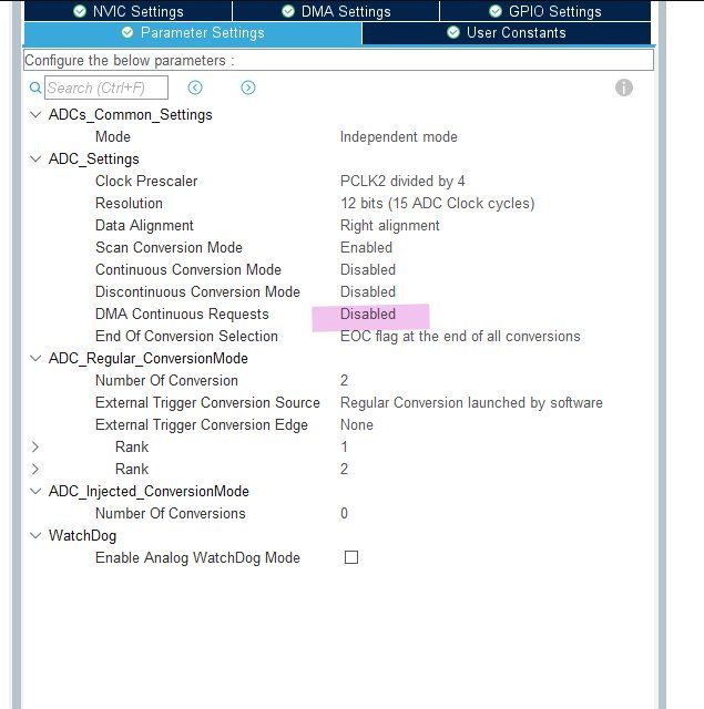

Below is my main.c file. I'm wanting to scan analog pins PA0 and PA1. They work individually when not using DMA, but when I try to use DMA, the analog values are read once and then never updated after that. Any ideas?

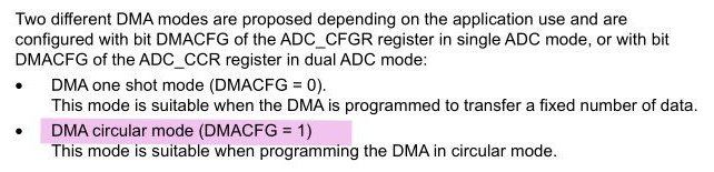

2024-07-05 3:50 PM
You need to set the DMA channel to "circular" mode in CubeMX. Did you?
2024-07-05 4:36 PM
Yes I did
2024-07-05 4:46 PM
2024-07-05 5:34 PM - edited 2024-07-05 5:36 PM
2024-07-08 9:49 AM
Sorry, that was indeed enabled, it was an old screenshot. Still not working
2024-07-08 10:16 AM - edited 2024-07-08 10:24 AM
The chain of events looks something like this:
Trigger Conversion Start ->ADC start conversion->ADC conversion complete->ADC DMA request->DMA transfer.
You've set up the DMA to work in circular mode and told the ADC that the DMA is in circular mode, but what is triggering subsequent conversions? you either have to provide a periodic external trigger from another peripheral (such as a timer) to start conversions, periodically start an ADC conversion from software, or you need to configure the ADC to continuously perform conversions.
2024-07-08 10:36 AM
Turns out the issue was that the ADC clock was running too quickly. Changing the prescaler made it work. Thank you!
2024-07-08 11:08 AM - edited 2024-07-08 4:58 PM
So nothing is triggering ADC conversions, but changing the prescaler suddenly means it's producing an infinite stream of conversions? very unlikely.
2024-07-08 11:31 AM
Thanks for your help Barry. In the IDE, I messed around with every ADC setting possible, trying numerous combinations. The screenshot above was only one of the combinations I tried (in fact, I posted the source code, changed it, and then tried to recreate those settings for the screenshot). The continuous ADC conversion mode needs to be turned on with software triggers (something I did previously try), like you mentioned, but it would not work with any prescaler lower than 8. The prescaler was the only setting I did not change in my testing, hence why it took me a while to find it.
Still, thank you for reminding me about needing adc triggers.
