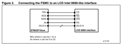

The LCD that needs to be driven by STM32F407 over FSMC interface needs also to have 8080 parallel interface:
Please refer to this application note: https://www.st.com/resource/en/application_note/an2790-tft-lcd-interfacing-with-the-highdensity-stm32f10xxx-fsmc-stmicroelectronics.pdf

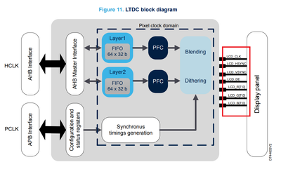

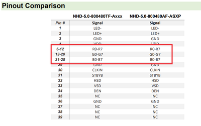

If the LCD has RGB interface R, G, B lines, you cannot drive the LCD with STM32F407 but you can with STM32F429 over LTDC:
From the LCD datasheet:
Refer to this application note: https://www.st.com/resource/en/application_note/an4861-introduction-to-lcdtft-display-controller-ltdc-on-stm32-mcus-stmicroelectronics.pdf
