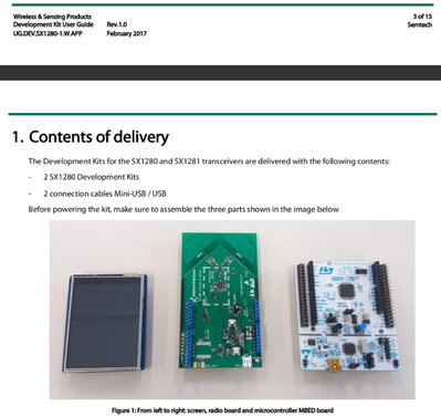

As @jamessmite says, see Semtech's site for drivers, SDK, etc for their chips
https://www.semtech.com/products/wireless-rf/lora-connect/sx1280 - see the 'Software' tab.
Note that Semtech's own devkit for the SX1280 is based on an STM32 Nucleo board:

@JamesParking wrote:
a Semtech SX1280 Evaluation Board
What board, exactly ?
Make sure that it doesn't interfere with the VCP connection (on Arduino pins D0,D1) ...
First try to get just the VCP connection working without this extra board attached
