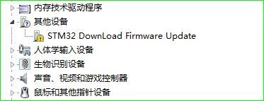

I wanted to test DFU function with my STM32F401 board, and my Win7 has installed DfuSe V3.0.4. After I plug USB to PC, it shows the driver is not corrected, so DfuSe can't recognized the USB device.I searched the forum but havn't find a solution, can anyone give some advices? thank you very much!Daniel

You can find the screen shot here:

I did use my own DFU code, and runs in user flash.Today I tried system bootloader:I set BOOT0 as 1, BOOT1 as 0 and connected to PC, it can show''STM32 Bootloader'', however, it still can't find the driver:-(2015-08-13 9:10 AM
Do you have any settings/policies in your Win7 install that might preclude the loading of drivers, or expect them to be signed etc? Are you an Administrator on the machine? Do you have IT people responsible for the machine?
Having installed the DFU software, there should be a driver directory, run the explicit installer if you need too.C:\Program Files (x86)\STMicroelectronics\Software\DfuSe\DriverDoes Windows provide a specific error? Or just that it can't/won't load the driver?2015-08-14 12:47 AM
