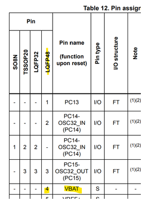

You're probably out of luck here with the VBAT pin requirement. All chips have RTC/I2C.
No SO-8 chips have a VBAT pin. The STM32G0 series has that pin, but only in the LQFP48 packet. My guess is other series are similar.

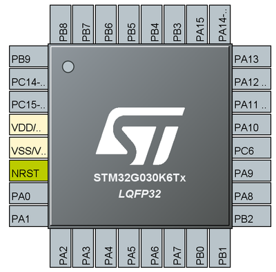

Hello and thank you, I found this:
You have many pins that will be unused, but it's the smallest one I found with VBAT.
Thanks again and greetings.
2024-01-12 4:03 PM
The STM32G030K6T6 (LQFP32) does not have a separate VBAT pin. Only LQFP48 chips from that series have one.
2024-01-12 4:12 PM
Yes, I realized after posting, it's already corrected.

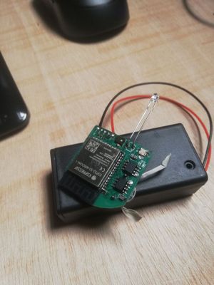

2024-01-12 4:13 PM
Currently, I am using this one, but it costs 5€, and the STM32, besides saving me the external RTC, doesn't even reach 1€, and that is magnificent!!
