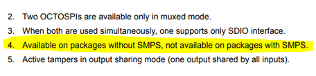

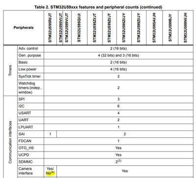

The DCMI interface is not supported in the STM32U595RJT6Q, but is supported in the STM32U595RJT6 as mentioned in the datasheet.

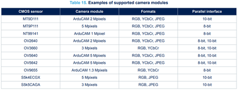

To know if a CMOS sensor (a camera module) is compatible with the DCMI or not, the user must check the
following points in the CMOS sensor specifications:
• parallel interface (8-, 10-, 12-, or 14-bit)
• control signals (VSYNC, HSYNC, and PIXCLK)
• supported pixel clock frequency output
• supported data output
AN5020 application note mentioned some CMOS sensors examples that are compatible with the STM32 DCMI.

2025-10-15 5:44 AM
Hello @Ankur_1 ;
The issue is fixed in the datasheet DS13633 Rev3.
Thank you.
