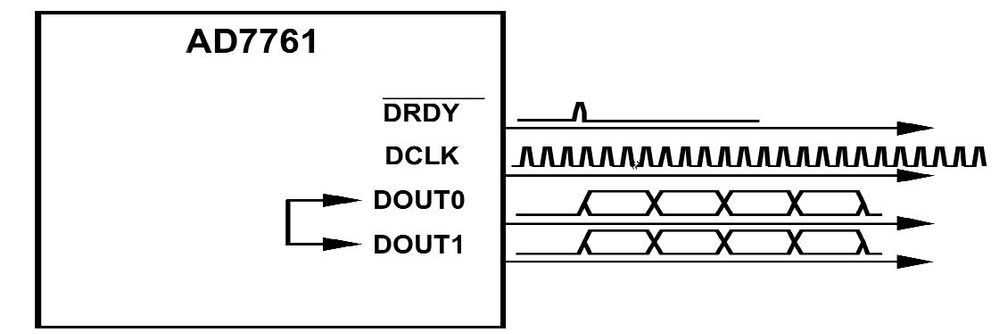

This is the device sending the data to the mcu:
So the DRDY is triggers the timer, dclk is free running and is the external clock fed into the timer, the Dout pins are split into 16 lines using a shift register and read in via the gpio. so the data following below shows the correct value of 9 and then incorrect values of 18 and 36 when the timer is delayed enough that the data propagates through the shift register.

The 9 is correct and that relates to
0000 0000 0000 1001
but the 18 and 36 shouldn't be there
18 being 0000 0000 0001 0010
36 being 0000 0000 0010 0100
So when it reads 18, it seems to miss it by 1 clock cycle of the external clock and the 36 by 2.
So I can see that it does read in the data and does it quite well for the majority, but every now and then it reads in the data either one clock cycle or two late and the data is slightly shifted.
