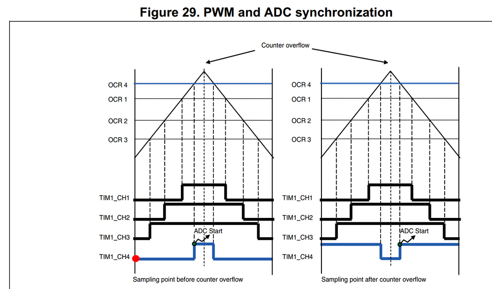

This is screenshot from ST FOC User Manual. Here is injected one ADC conversion, triggered by TIM1_CH4. I need add injected conversion on timer update event (red point - fixed, green - isn't). Is it possible?
I alredy disable the discontinuous mode for injected group, but I can't generate two trigger event every PWM cycle...
