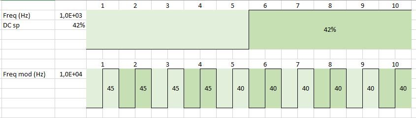

So, what I did next:
Thus, for 10 interrupts of TIM4 I would have 1 period in TIM1. For each interrupt in TIM4, I adjust one of the ten values calculated, I expected the amount would be the 42% and my wave form would have the 42% of duty cycle. However, what it is actually happening is that the last vector from the ten values is adjusted as dutycycle.
The interrupts are occuring correctly and timers seem to be synchronized; Below it is the interupt from TIM4 part.

2020-05-22 4:40 AM
Thank you, I appreciate your suggestions.
Related to use another TIM: I was looking for way to achieve a duty cycle in a 1% step even if configured for a 5% step. So the whole idea was to change my duty cycle in fractions of period, so the final average would be, for the example below, 42%.
2020-05-22 4:54 AM
The lower waveform is the output PWM going to the filter?
And the upper is the timer in which interrupt you modify the duty of lower one?
Which one is TIM1 and which one is TIM4?
Note, that the resulting waveform will have frequency components of not only the PWM "baseline" but also of the lower frequency "modulation". In other words, depending on the particular filter you use, you'll still "see" some of the modulation frequency on the output - maybe less than if you'd simply use a lower frequency PWM capable of the required resolution, but still being present. It depends on your application. how much this matters.
PWM is generally a cheap but inferior method of DAC. Use real DAC if you want a stable output with high resolution.
Maybe you should tell us what did you want to achieve at the first time.
PS. Namesake, germanized version of the name?
2020-05-22 6:00 AM
So cycle through the 10 values and set them up as
45 45 45 45 40 40 40 40 40 40
You'll get a net 42% duty cycle.
I still don't see why this needs a separate timer.
If you're trying to do something more complex, you'll need to explain it better.
2020-05-22 6:12 AM
The lower is TIM4 and upper is TIM1.
Actually, the upper waveform is my PWM output. Now the lower is where I modify the duty cycles (5% step) of the upper in little fractions so I can result in the desired duty cycle (of 1% step).
I want to develop a PWM module, with frequencies of 1Hz - 100kHz (step of 1Hz) and duty cycles of 1% step. But configuring my proc to this I obtain errors of more than 5kHz in the high frequencies, so I was looking for an alternative to decrease my error.
I've already tried the dithering technique, but I was not able to understand the implementation very well.
PS. It is czech, origin from Vaclav name.
