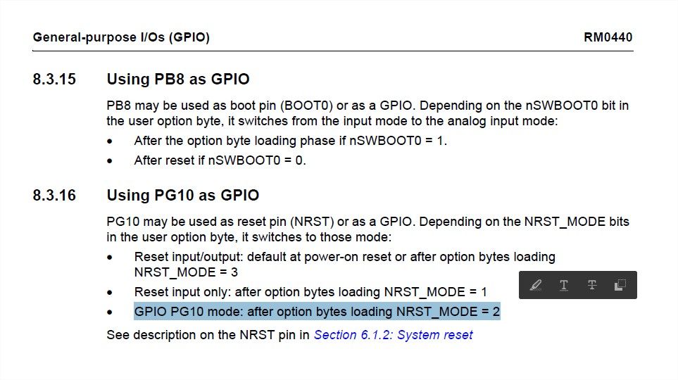

2020-11-13 6:18 AM
@Community member I think the Option bytes was the solution, I changed them with the STM32 Cube Programmer the NRST Mode to 2, now its working and I can use PG10 as Push/Pull output

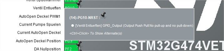

Do you have an idea about this topic? Can I use the NRST PG10 PIN as Output or not? In cubeMX I can set it as push-pull, hope this is no bug in the MX?

I saw this entry, Its not working correctly but I saw when I connect with multi meter to measure the voltage level on this PIN the Core is getting resetted even if the impedance is really high...
2020-11-13 6:18 AM
