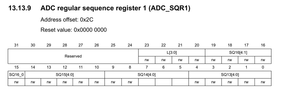

P.S. In the ADC_SQR1 there is a "bit-space" named "L[3:0]" (screenshot attached). I believe this bit-space stands for the "number of conversions you wish to make". This bit-space was set to 2 when I selected the rank/priority/sequence to be 2 and 16 when I made the priority 16. So I don't think the configuration of 'L' might be the issue. But please do let me know if my understanding is wrong.

In your case, you use ADC1 with only the Temperatur Sensor (internal channel 16).
So, you only have one conversion sequence, specifically the first ADC_SQR3 -> SQ1[4:0].
You do not need to configure the other sequences in ADC_SQR1 or ADC_SQR2 . Refer to RM0090 rev 21 in section 13.3.10 Discontinuous mode - Regular group.
