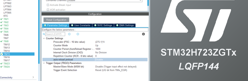

I'm using Nucleo H723 board. I have used 8 timers in encoder mode to read the encoders. I have also activated another timer to make an interrupt every 4ms to send the data via Usart.
everything work good but when I use sprint code to put the data in Usart, the interrupt time has been changed and it's not 4ms.
Part of my code inside interrupt:

}Hier is my timer configuration.
when I delete the sprint codes the timer 4ms runs again correctly.
I appreciate it if you help me.
