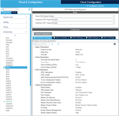

Apologies for the late reply. I could not get the registers content as I'm having trouble viewing the 'Registers Window' in Keil.
Here's my SPI configuration.
