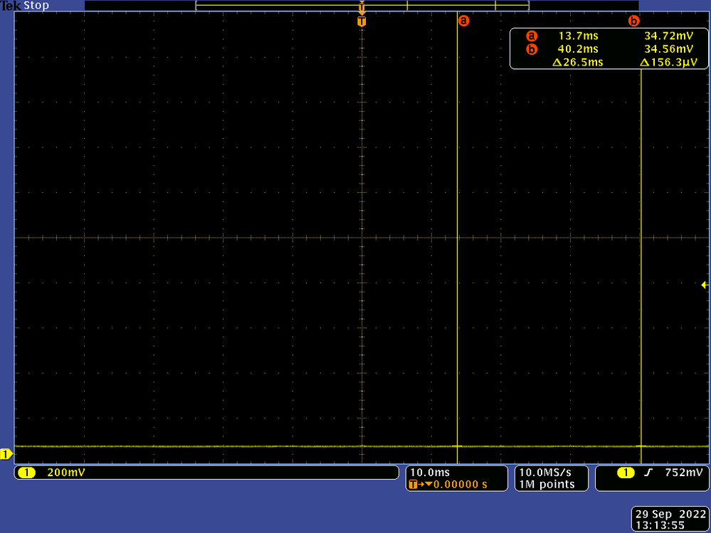

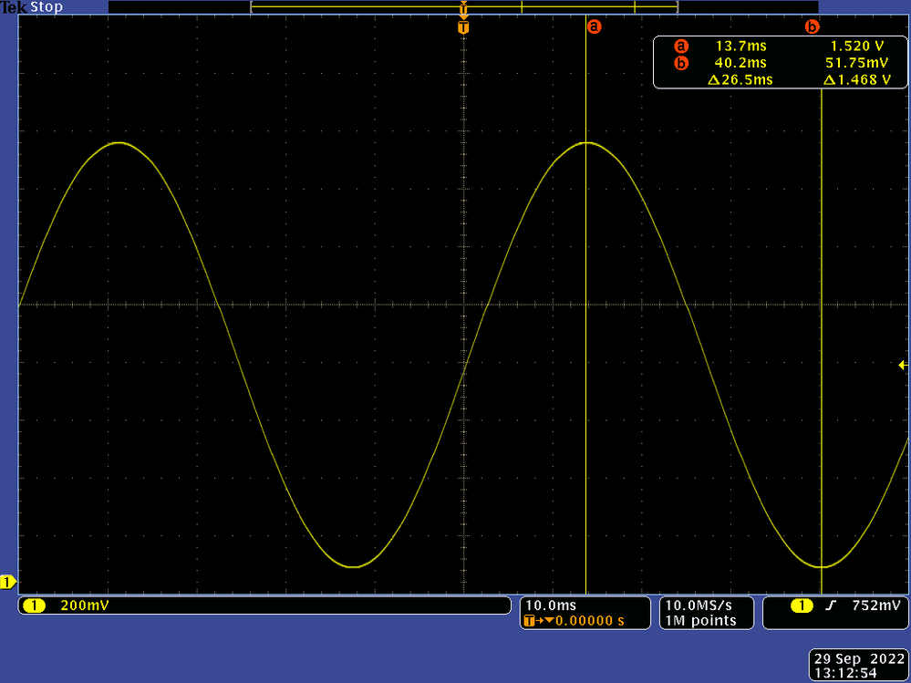

I use the B-U585I-IOT02A, modified VREF+ pin to be powered from internal VREFBUF 1.5V. Then I use the DAC1 to produce a sine wave, it gets quite close to the rails.
0693W00000UFRPIQA5.pngThe offset of the oscilloscope is around 35mV:

Then I sample the signal with the ADC1 from PA4, also using 1.5V as reference voltage using a pretty plain setup (no oversampling etc) and feed it to the MDF.

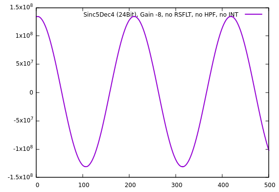

When I use the CIC stage with SINC5 and a decimation of 4, this should result in 24bit wide internal results.

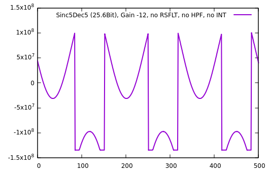

0693W00000UFRR4QAP.pngWhich gives a nice sine wave. However, if I use the same setup with decimation 5 then the internal results are 25.6bits wide - which is ok according to the datasheet - and I get this:
0693W00000UFRRsQAP.pngTo get this, I had to switch off the SATuration interrupt.

  • Sinc5 - Dec4 the maximum amplitude read is 1.3e8 which can be represented on 27.9 bits. The maximum value on 24 bits is +/- 8.39e6
  • Sinc5 - Dec5, firstly there is an offset in the injected signal. It seems that with a full scale signal (14 bits) + offset a wrap-around occurs.
I will reproduce on my side but I don't expect an issue with the MDF. I come back with further analysis.

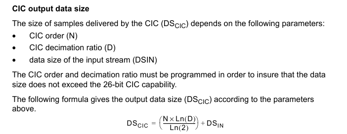

I'm referring to the Reference Manual
RM0456
Reference manual
STM32U575/585 Arm®-based 32-bit MCUs
March 2022, RM0456 Rev 3, page 1239
where it says:
with N = 5, D = 4 and DSin = 14 this results in
DScic = 24
and with N = 5, D = 5 and DSin = 14 this results in
DScic = 25.60964
Both values are within the recommendation DScic < 26bit.
