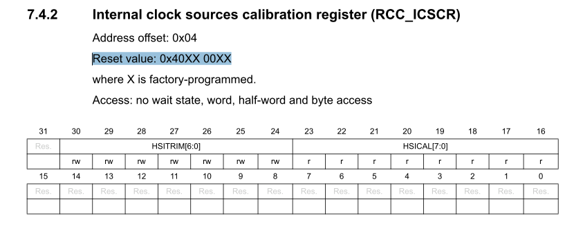

Hello @Arnold Bischof ,
Thank you for bringing this error to our attention.
I confirm the mistake in description of HSITRIM[6:0].
The default value should be 64 (as written in default reset value of register: 0x40 = 64).
An internal ticket (ID 120186) is submitted in order to correct this error in the next RM0440 revision.
(PS: ID 120186 is an internal tracking number and is not accessible or usable by customers).
Thanks
Imen

2024-03-14 6:50 AM
I would inform you that this issue is fixed in the latest release of RM0440.
Thank you for your contribution.
