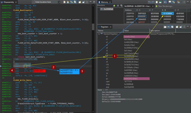

2024-06-19 8:48 AM - edited 2024-06-19 8:59 AM
Hi @waclawek.jan,
yes, I understood your point. By following your instructions, I was able to locate the offending code.
The issue is created in the following function that first reads and then updates the flash:

When the pc points to the 08002fc0 address the memory contains:
0x2000FFD8: 4F4E0000
0x2000FFE0: FFFFFFFF
When the adds operation is executed, r7 changes from pointing to the memory address 0x2000FFD8 to the new address 0x2000FFE0 which now contains an invalid memory value: 0xFFFFFFFF.
I stepped through then the entire FLASH_BootCounter function and I found out that the issue it is in the FLASH_Read_Data function.
I then stepped through the FLASH_Read_Data function disassembly (it took me all day!) and here are the results:

08003098: nop --> r1 = 0x2000FFDC, r2 = 0xFFFFFFFF, r3 = 0x0, r7 = 0x2000FFC0
0800309a: adds r7, #20 --> r7 = 0x2000FFC0 + 20 = 0x2000FFD4 (contains 0x2000FFD8)
0800309c: mov sp, r7 --> sp = 0x2000FFC0
0800309e: pop {r7} --> sp = 0x2000FFD4, r7 = 0x2000FFD4 (contains 0x2000FFD8)
080030a0: bx lr --> sp = 0x2000FFD8, r7 = 0x2000FFD8 (contains 0x08003B27)
returns from the code above <----------------------------------------------------

08002fc2: mov sp, r7 --> sp = 0x2000FFD8, r7 = 0x2000FFE0 (contains 0xFFFFFFFF) <<<<<<<<<< here the wrong memory address is pushed into the stack
08002fc4: pop {r7, pc} --> r7 = sp = 0x2000FFE0 (contains 0xFFFFFFFF)
--> sp = 0x2000FFE8, r7 = 0xFFFFFFFF
08002fc6: nop
08002fc8: strb.w r0, [r0, <undefined>]
The FLASH_Read_Data function seems to be a kind of do-while loop, which reads the requested flash memory, but also reads the next value, which "coincidentally" it contains 0xFFFFFFFF, as that memory address is empty.
When this value is read, despite the N (negative bit) being set, the operation doesn't happen, and the registers still contain the wrong values, leading to r7 being loaded with this invalid memory address.
I have to admit that, in an attempt to be quick (which turned out to be the very opposite), I copied that function from a website. I will never do that again. I would have never written that function in that way, but I can't find anything wrong that would trigger such behavior.
Here the offending function:
void FLASH_Read_Data (uint32_t StartPageAddress, uint32_t *data, uint16_t n_words)
while (1)
*data = *(__IO uint32_t *)StartPageAddress;
StartPageAddress += MEMORY_OFFSET;
data++;
if (!(n_words--)) break;
I then updated that function to be like in the official example:
uint32_t address = StartPageAddress;
uint32_t EndPageAddress = StartPageAddress + n_words * MEMORY_OFFSET;
while (address < EndPageAddress)
*data = *(__IO uint32_t *)address;
address += MEMORY_OFFSET;
... And now all works as expected, and stepping into the disassembly I didn't spot anything wrong.
Your insights on this would be greatly appreciated (@waclawek.jan, @Tesla DeLorean) as I'm sure yu would help me to finally understad what happened under the hood.
One more thing, how should I start to write code to defend myself from these hidden traps? Can you point me to some good articles that explain how provide to the code a sort of "watchdog" :face_with_tears_of_joy:?
Many many thanks!
:folded_hands:

>>Why did you point to that particular instruction?
Because it's the WRITE that's causing the IMPRECISE fault
r7 == 0xFFFFFFFF is problematic, suggesting it got trashed somewhere along the way, assuming the compiler didn't generate bad code. It's probably a pointer to one of your structures, perhaps locally on the stack.
Code/Execution level failures can occur if the FLASH Wait States are too aggressive, especially in the prefetching paths.
Perhaps it's a code inlining optimization issue? Is the boolean value used anywhere? It looks like it staged unnecessarily (where r7=sp, local on the stack frame), and then passed to the function.
2024-06-20 6:23 AM - edited 2024-06-20 6:23 AM
it's simpler than that. Look at the end of loop condition of this function:
while (1)
data++;
}It reads from FLASH and writes to destination (which is given by pointer) one more word than is n_words, so
uint32_t last_boot_counter, new_boot_counter; FLASH_Read_Data(FLASH_USER_START_ADDR, &last_boot_counter, 0x1U);
writes 2 words to stack (as last_boot_counter is a local variable), and thrashes what's just after last_boot_counter, which happens to be the stacked stack frame pointer in r7 from the caller function. And that thrashed stack frame pointer then just propagates to the point where it's actually used, resulting in the fault.
@aga,
I could preach here "proper coding methods" etc. Some folks believe religiously in the power of tools like static checkers or various fancy programming languages.
But the naked truth is, humans make errors. So, the practical solution is to a) try to be as meticulous as possible within reasonable boundaries; b) be prepared for errors at various levels.
In this particular case, for example, in FLASH_Read_Data(), I would use the for() loop rather than do/while() or while(). There's a reason for the for() loop - it's usually perceived as a simple alternative and it's more readily understood, if one sticks to the simple for(i = 0; i < max; i++) pattern; so it's less likely to result in error.
And, also, in this particular case, you have been able to track down the root cause and mitigate it (by using the correct FLASH_Read_Data()). I never consider the "the problem went away, although I'm not sure why" to be an acceptable solution; that's why to me it's very important to maintain the problem (i.e. don't make any subsequent changes, unless I can surely undo them) until I am absolutely sure what was the root cause and that I removed it.

2024-06-20 7:51 AM
Yeah, responding to an earlier post, not the more detailed/focused one.
2024-06-20 9:09 AM
It's not "stack pointer" but "pointer to stack frame". Stack frame is the name of the space on stack the compiler makes upon entry to a function, so that it can place local variables there and, in some cases, also temporary variables it is unable to hold in registers (so called "register spills"). Compiler needs to maintain a pointer to that space, as it is not a fixed value, it depends on where top of stack (pointed to by stack pointer) was at the moment the function was called.
But upon function entry, before creating the stack frame, the compiler needs to push on stack registers it intends to modify in that function (except r0-r3, which are used as parameters upon entry/return values upon exit/freely modifiable in the function).
For example:
FLASH_BootCounter:
08002f98: push {r7, lr} --> r7 = 0x2000FFF0 (contains 0x20000A10), lr contains the returning address
08002f9a: sub sp, #8 --> sp = 0x2000FFE0 (contains 0x2000FF0)
08002f9c: add r7, sp, #0 --> r7 = 0x2000FFF0 sp = 0x2000FFD8 (contains 0x8003B27)here, in the first instruction, lr (the return address) and r7 are pushed first, as the compiler intends to use r7 in that function; then moves the top of stack to make space for the stack frame - here for two local variables, and stores that address into r7 to be used as pointer when those local addresses are to be used.
So, on stack, we have
r7-> [new_boot_counter] [last_boot_counter] [saved r7 of caller] [lr i.e. return address] [... stack content of caller ...]
Now calling FLASH_Read_Data(FLASH_USER_START_ADDR, &last_boot_counter, 0x1U); wrote two words instead of one, so it wrote last_boot_counter, but also corrupted [saved r7 of caller]. When FLASH_BootCounter finished:
--> sp = 0x2000FFE8, r7 = 0xFFFFFFFFthat corrupted r7 is popped from the stack. Execution returned to the function, which called FLASH_BootCounter() (I don't know how is it called, let's call it X), where apparently r7 is again used as stack frame pointer for the local variables of function X. And then later, in function X, a local variable bRead_speed is accessed:
bool bRead_speed = Shaft_Measure();
(while bRead_speed is defined in the middle of the function, the compiler gathers all local variables throughout the function and creates one common frame at the beginning of the function). However, r7 now points to invalid address and that access then causes the fault.
