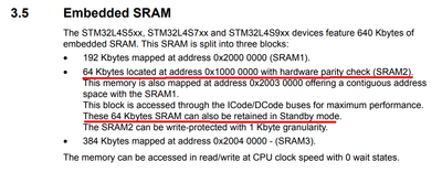

2025-04-02 3:09 AM
According to the product datasheet, SRAM2 retains the data after reset.
Regarding the backup SRAM, it is designed to retain its content even after reset, as long as the backup domain is powered.
2025-04-02 3:09 AM
2025-04-02 4:20 AM
Thank you for your feedback.
Yes, I used this memory to implement this feature, It' work perfectly.
