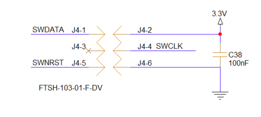

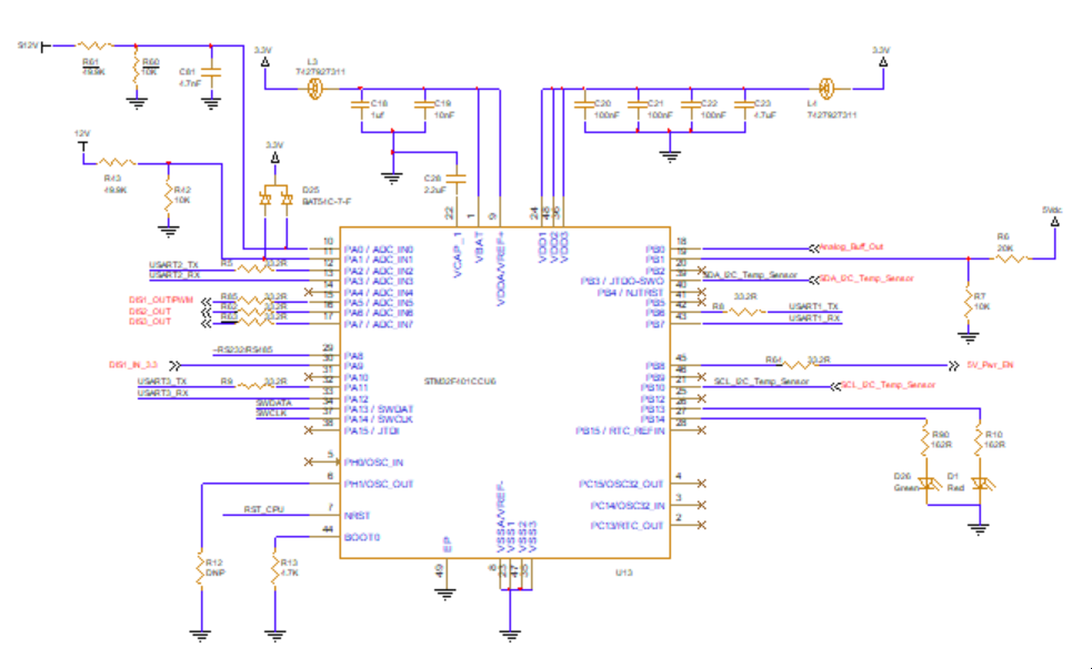

It seems i have no problem erasing and programing the uC in old versions of STM programmer. Only the new STM CUBE is not reading the uC.
Here are some schematics:
2022-11-14 5:53 AM
Programming Connector used:
2022-11-14 5:56 AM
Check firmware and cables
Check connectivity modes, and speeds.
Is NRST connected to the debug pod? Needed for "Connect Under Reset" to work as expected.
ST-LINK/V2 or V3, authentic, or clone?
Avoid using USB Hubs or Docking Stations.
With Micro USB cables make sure to use data or USB 2.0 rated cables, and not charging cables.
