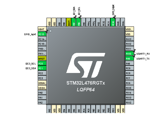

2020-08-04 11:10 AM
Here is the pin diagram from the IDE. The initialisation is also generated by the IDE:

2020-08-04 11:15 AM
I think it's nearly impossible to have multiple GPIO electrically short within the package.
Also, unless using tricky interrupt scheme, most likely both I2C should be time shifted if the code runs them sequentially... or you are running the same code on both I2C.
The above code doesn't talk about GPIO pin settings, only peripheral setting...

2020-08-04 12:28 PM
I don't understand. Do you see identical waveforms where exactly? Did you try a minimal program, with only one I2C? Did you try wiggling the pins manually? What board is this?
2020-08-05 4:06 AM
