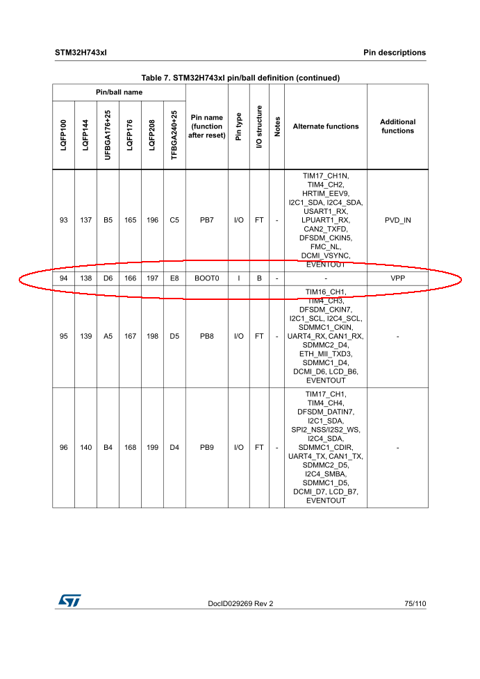

From the datasheet (this is for 'H743, look into datasheet of your mcu, it will be the same):

I referred the App Note AP2606, but i didn't get the information required. I would like to know, the pin details where exactly the ISP pin is located in STM32H753ZI MCU?
2019-09-09 10:56 PM
We still don't know what exactly do you mean by ISP.
STM32 can be programmed either using the debug interface - SWD or JTAG - or through bootloader. For former, review the Debug infrastructure chapter in Reference Manual (RM); for latter, refer to AN2606.
2019-09-09 11:38 PM
In-System Programming (ISP) and In-Application Programming (IAP) via on-chip boot loader software. To set forcefully in to boot loading mode through hardware, where can i found this pin in pin details of STM32H753ZI MCU?
2019-09-10 1:20 AM
