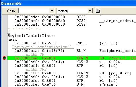

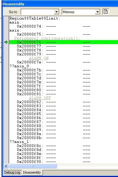

I do like you said me but that is the only i can see. I dont want this. I want code like:
What am I doing wrong?? I´ve checked Project/options/C-C++Compiler/List:
Output list file and Output Assembler file. One of each and both of them ways.
gdiez
Associate II
Posted on May 17, 2011 at 14:21
I know the reason. I was programming with STlink JTAG debugger and it must be done with SIMULATOR or altmost it works only in that way for me.
